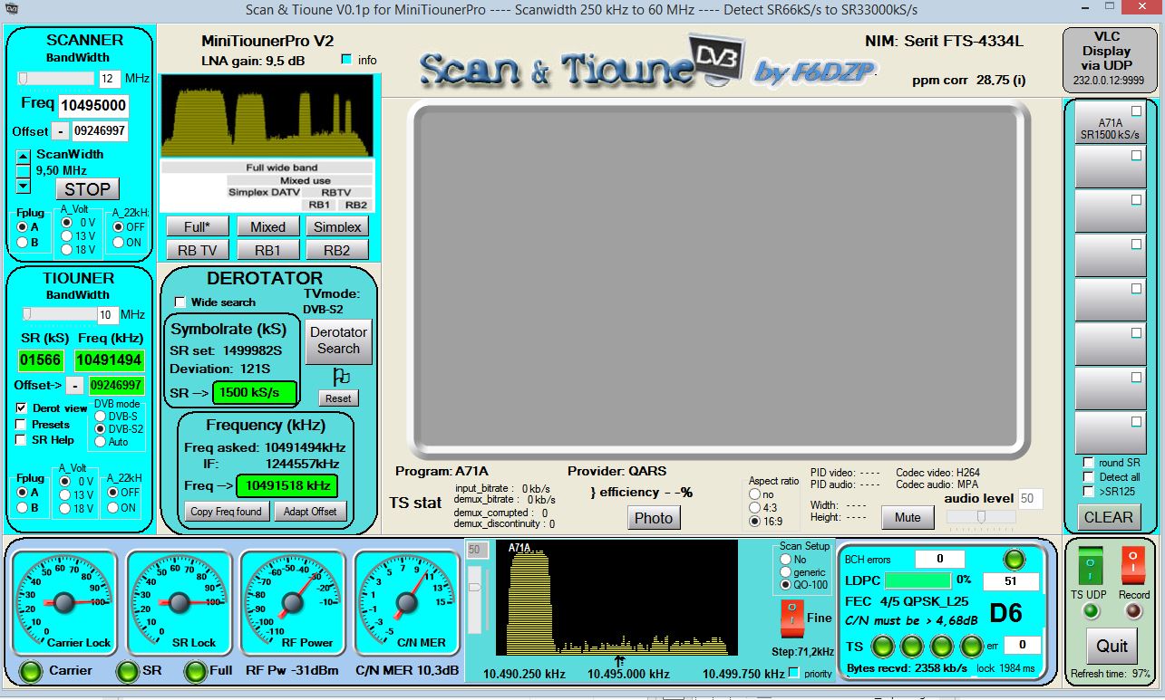

Messagede DL8SDQ » Sam 22 Aoû 2020 09:06
I changed now the setting to
Conf_AddrUDP=232.0.0.12
Conf_Port=9999
Conf_LocalIP=172.24.53.211
This is the result of the beacon.
download/file.php?mode=view&id=1883
I get the UDP indication in the upper left corner but no Video in scan and Tioune and no video in VLC (udp://@232.0.0.12:9999).
So what I do not understand is why the 232.0.0.12 shall be a multicast address.
Normally with UDP the address xxx.xxx.xxx.255 is a multicast for this sub net. So all devices will listen to this and if you select the right port you can read the data.
This is working with the VLC player if I put 172.24.53.255 and put VLC (udp://@:9999)so I read the stream in VLC player, But the scan and Tioune can't read is
2020-08-22 10_56_21-G__TEMP1_WE_AFU_QO100_Sat-Receiver_2_Scan_Tioune for BetaTest - FreeCommander XE.jpg
2020-08-22 10_56_21-G__TEMP1_WE_AFU_QO100_Sat-Receiver_2_Scan_Tioune for BetaTest - FreeCommander XE.jpg (216.18 Kio) Vu 96697 fois
DL8SDQ
Inscription: 28 Oct 2019
