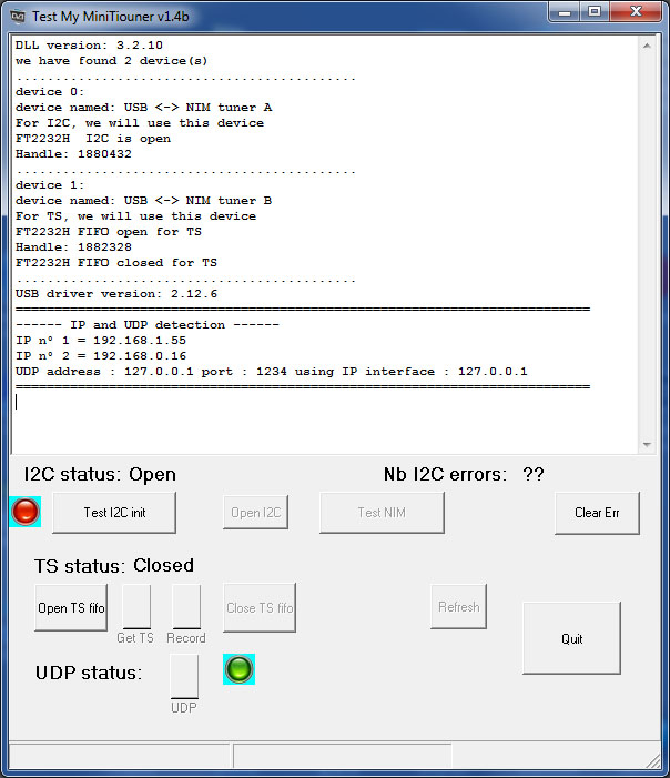

Messagede G8VPG » Mer 19 Avr 2017 08:13
Jean-Pierre,
Herewith the screen capture that I get;
Thank you for your help and advice.
73 Shaun.

Re: Problem installing Minitioune with XP
Messagede F6DZP » Jeu 20 Avr 2017 06:10
Ok, your PC cannot talk with the FT2232H
are you sure that your USB plug is USB2, not USB1?
(If your computer is too old, it has only USB1 port)
