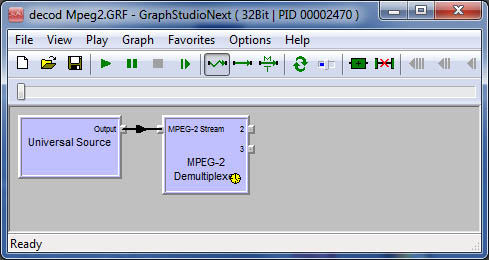

So I will try to do exactly what Minitioune do, using GraphStudioNext
1) I load the "decod Mpeg2" graph
decod mpeg2 graph.jpg (50.39 Kio) Vu 95493 fois
The 1st "brick" is the source the receive the TS from Minitioune, the second brick is the demultiplexer that separate the video (pin2) and audio (pin3) streams.
I cannot have a complete graph for rendering video and audio because I don't know the codec and renderers that are installed on your computer, so it is why I start with the begeinning of the graph and will ask Windows to find the remaining bricks.

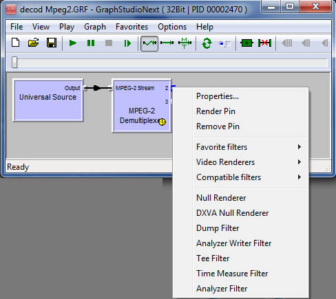

2) I do a right-click on pin 2 to ask Windows to render the video
decod mpeg2 graph right click on pin 2.jpg (70.79 Kio) Vu 95493 fois
3) I get the result :

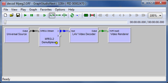

decod mpeg2 graph with video renderer.jpg (62.93 Kio) Vu 95493 fois
We can see that we have now the video decoder

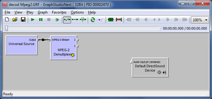

4) I do a right-click on pin 3 to ask Windows to render the audio === > GraphstudioNext cannot get the result from Windows and we quit!!!
So it is impossible to create the whole graph, so it is impossible to render video and audio.
We have the explanation why Minitioune cannot show us the video, why the graph led is Red.

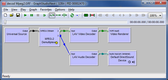

We sould have the resulting graph that can render video and audio:
decod mpeg2 graph with videoand audio renderers.jpg (72.47 Kio) Vu 95493 fois
But we can't get it automatically on this computer

Using graphstudionext, I have changed the "decod Mpeg2.grf" graph , adding the audio renderer.
I have now:
decod mpeg2 graph working OK on this computer.jpg (59.4 Kio) Vu 95375 fois
I have save this new graph as it is above, keeping the same name.
Do the same thing for the "decod H264.grf" graph
NEVER DO THAT:
decod mpeg2 graph with videoand audio renderers.jpg (72.47 Kio) Vu 95375 fois
because your PCwindows MUST LINK ITSELF THE audio and video codec
This is just a sample to see what is created on my computer and saved as "newdecod Mpeg2.grf"
This final graph is not the same on each computer, that is why I cannot give it all already made.
On your computer, your Windows will choose itself the codecs, depending which are installed, the value of Merit they have, ...
So you cannot choose yourself!
let windows do it.
Has you have seen on the post, Ken's computer has not choosen the LAVvideo decoder but the Microsoft DVD video decoder.
