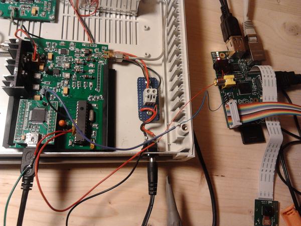

Few mounths ago, I proposed to replace the PC with a Raspberry and its HD camera : such a litlle computer seems to be enough power to make the capture of video, encode it in H264 (more efficient encoder compare to MPEG-2) and canal coding outputing IQ to USB. This was tested with the Digilite modulator. At this time, it still require to have a serialiser (FTDI) and a dsPic for demuxing the incoming IQ Bytes data and set a stable clock.
Because most of the operating systems running on PC or Raspberry are multitasks, it is very hard to have a very stable output to feed logic components. That's why we generally use FIFO which works like a smoother of incoming data which are bursty.
I discover that the PWM output on the Raspberry could be used as a data serializer. By using DMA (Direct memory access), it ensures that the data are sent rugularly (strictly) and allows to send bit at very precise time (driven by the PLL clock of the Raspberry). Fortunatelly, there are 2 PWM output on Raspberry : this allows one stream of I and one stream of Q.
Plugging I/Q to a quadrature modulator like U2790 to go RF. A nyquist filter should be used to filter and ensure no harmonic. But that's all : you have a DATV modulator !
THE UGLY SOLUTION : No additionnal harware needed
In order to avoid quadrature modulator, we can think about generating the RF signal directly. But generate a 1,2GHz waveform modulated in QPSK is not even possible using such a little CPU. However, Raspberry can generate a 250 MHZ square tone. We can also update it and then by divide by 4 to have 4 phases, we can generate a 62,5 Mhz. With DMA we can update to have a relatively good timing for changes the phase.
As the signal is a a square, it produce a lot of harmonics and we can still have a good level (enough for a DVB-S receiver) at 1,0625 GHz ! Some errors happen because of not so good timing, but Reed Salomon correct them hopefully.

After some test, I have found that it can modulate directly on 437.5MHz frequency (62,5 Mhz * 7 harmonic).
So a solution to modulate directly on this band.
