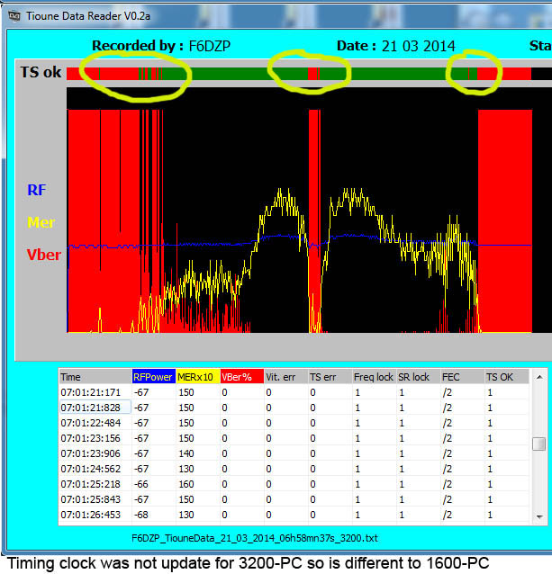

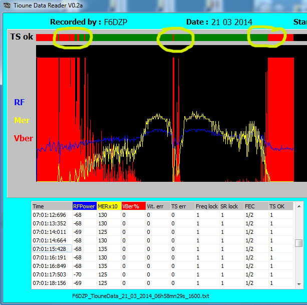

Today I have connected my dish, during one ISS pass, to 2 PC with both cards.
So each card has received same signal.
the result:
S2-1600
S2-3200
Little better for S2-1600 when signal is very low. But no so much differences in a real test as I believed.
I will show also the video of both TiouneMonitor during the ISS pass.
