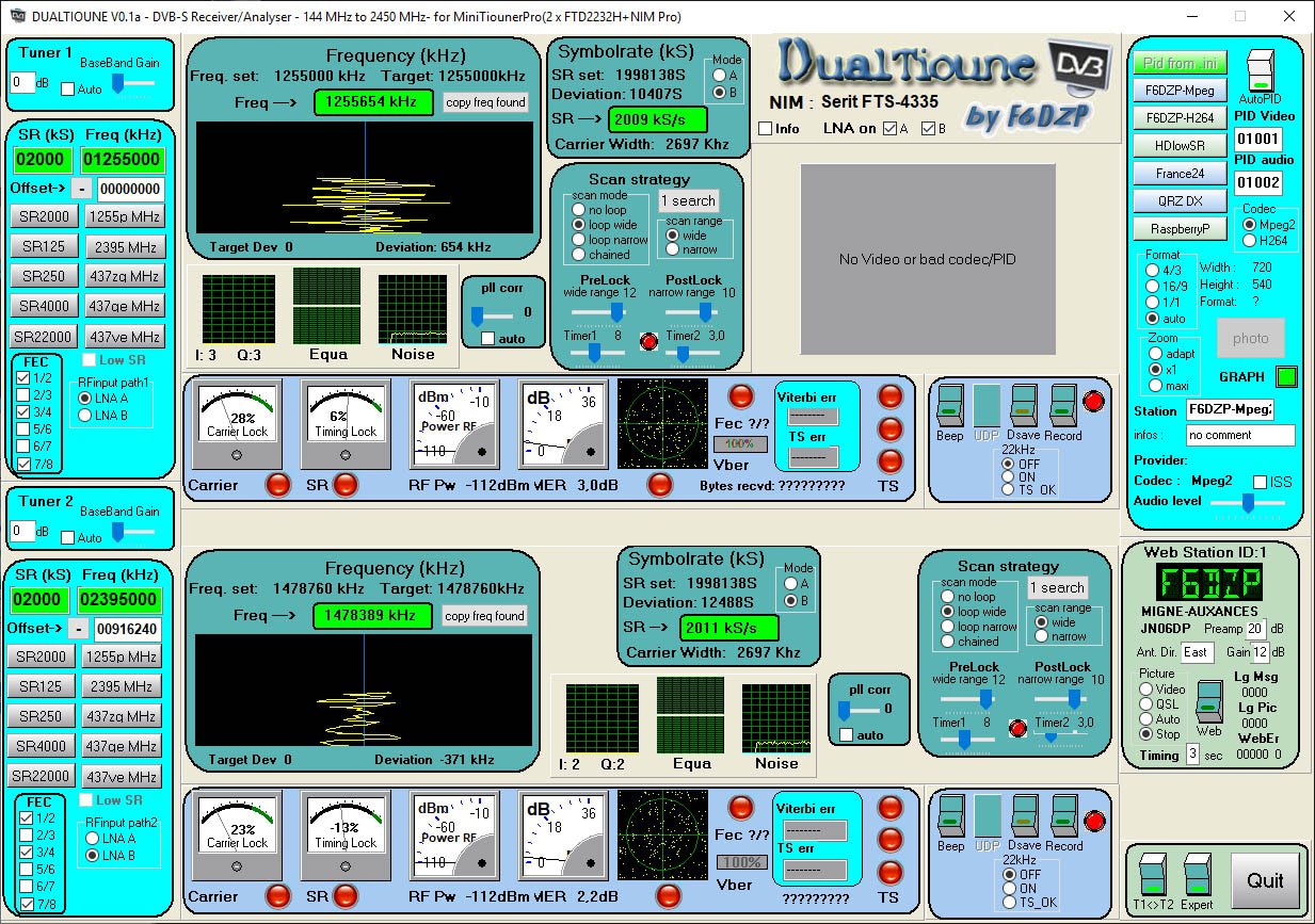

Messagede sm4ive » Mer 17 Juil 2019 12:55
JP
The dualtouner are done for 2 LNBs? or would it be enough with a 2 way splitter?
But how to watch 2 stations on the same time? Please explaine :-)
Thanks Lars
sm4ive
Messages: 13
Inscription: 14 Mai 2019
Re: DualTioune
Messagede F6DZP » Mer 17 Juil 2019 20:53
Lars,
Dualtioune is the software / MiniTiounerPro the hardware with the dual possibility.
To use Dualtioune on the same band ( as Oscar-100) you need only one input Fplug A or B
You don't need any splitter. All is done inside the NIM
The FTS4334L NIM has 2 tuners ( only one Fplug input will be used for Oscar-100 as all stations are on the same band from the same LNB) and 2 demodulators, so we can receive and demodulate 2 stations at same time.
Dualtioune can show us only one video at a time, there is the switch TS1/TS2 that allow you to go from one station to the other
But you can see both stations at same time if you send one of the TS to VLC using UDP. ( or send both TS to 2 instances of VLC).
That already works with the DVB-S version you can see here on my precedent post.
