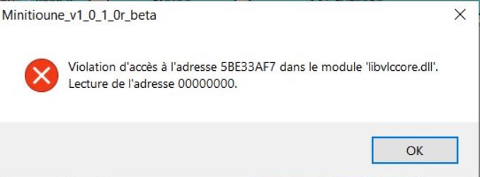

I am having problems between MiniTioune v1.0.1.0r and VLC. I run Windows 10 and installed VLC 32 and VLC 64 but seems Minitioune does not send anything to VLC via UDP.
I enabled VLC and Minitioune in Windows firewall through, also tried to downgrade VLC to earlier versions but nothing so far.
When try to enable VLCdll on the Renderer it comes up with the error message in the attached image
Thank you for any help to solve yhis
