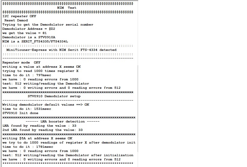

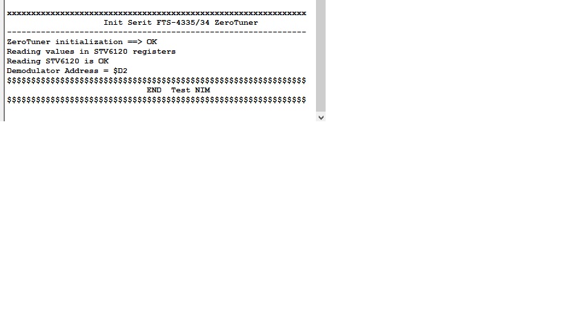

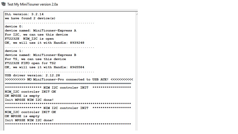

Messagede G8OUX » Mer 16 Oct 2019 14:00
Hi
I am using the MiniTiouner Express and it work fine on my main PC, just not on this laptop.
Here are the 3 pages from the TestMy Mini
Test NIM 2.jpg (44.74 Kio) Vu 92516 fois
Test NIM 1.jpg (139.27 Kio) Vu 92516 fois
IC2 Master init.jpg (94.69 Kio) Vu 92516 fois
G8OUX
Inscription: 16 Juil 2019
Re: MiniTiouner will not start.
Messagede F6DZP » Mer 16 Oct 2019 14:32
all seems Ok, and your MiniTioouner works on another computer.
so something is not working on this PC, I can't say more. Very difficult to fix If I have not the PC in my hand.
