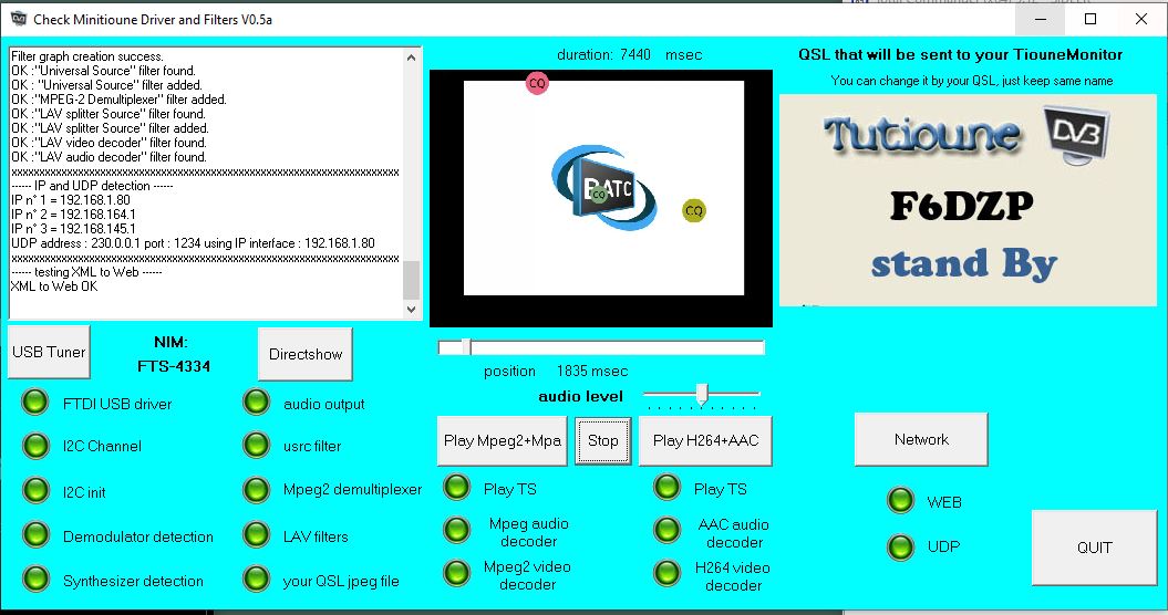

Messagede hb9ryz » Mar 1 Oct 2019 20:21
The Test goes through without any problems. But MiniToune is telling me "unknow-hardware". It's very bad, do not have a complete software package which is installing all needed driver after a major Windows 10 update. Flexradio Systems is also dealing with the same issues and found finally a solution with the new SmartSDR software v3.1.27. So I have switched off my MiniTioune pro v2 HW perhaps for ever :-( :-( no support, no solution, no DATV on QQ-100 :twisted: :twisted:

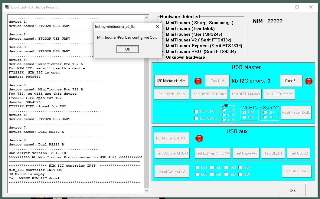

Hi Jean-Pierre
Here some screen shots from the test Software.

Messagede F6DZP » Mer 2 Oct 2019 03:08
?? no , the test (TestMyMiniTiouner) says that hardware is incompatible! same message than Minitioune.
with the screenshot of "TestMyMiniTiouner" I can see the problem.
your problem is : you have 8 devices ( device 1 to device 8!) with FTDI drivers and this version of Minitioune doesn't find: device 1 = "Minitiouner_Pro_TS2 A" and device 2 = "Minitiouner_Pro_TS2 B" or device 3 = "Minitioune_Pro_TS2 A" and device 4= "Minitioune_Pro_TS2 B" .. but a mix of 3 USB devices followed by 2 Minitiouner devices followed by 3 devices.
( before the update of win10 these devices were not in this order or you have added new USB devices so it could work
I had not tested this kind of situation ( 8 different FTDI USB devices at same time ...) before this beta release.
The new version of Minitioune I will upload in 2 or 3 weeks is supposed now to fix that.
the solution today is to unplug others devices, plug only the MiniTiouner_Pro, run Minitioune and plug after the others devices.
or do test by unplugging only one device or 2 devices or ...
I will send you personally the new version for test, you have one of the most complicated configuration...
