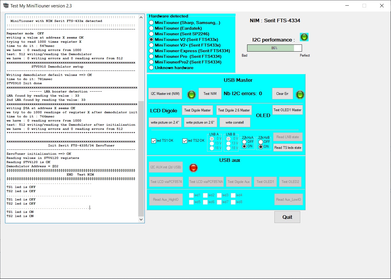

I attach screenshot of test my MiniTiouner.
This is what Test My Minitiouner says:
DLL version: 3.2.14
we have found 2 device(s)
device 0:
device serial N° DA3HOL6RA
device named: USB <-> NIM tuner A
For I2C, we can use this device
FT2232H NIM_I2C is open
OK, we will use it with Handle: 9499800
device 1:
device serial N° DA3HOL6RB
device named: USB <-> NIM tuner B
For TS, we can use this device
FT2232H FIFO open for TS2
OK, we will use it with Handle: 9499240
USB driver version: 2.12.28
>>>>>>>>>> NO MiniTiouner-Pro connected to USB AUX! <<<<<<<<<<<
****************** NIM I2C controler INIT *******************
NIM_I2C controler INIT OK
OK MPSSE is empty
Init MPSSE NIM I2C done!
NIM Test
I2C repeater OFF
Reset Demod
Demodulator Address = $D2
we get the value = 81
Demodulator is a STV0910A
NIM is a SERIT_FTS4335/FTS4334L
MiniTiouner with NIM Serit FTS-433x detected
Repeater mode OFF
writing a value at address X seems OK
trying to read 1000 times register X
time to do it : 547msec
we have : 0 reading errors from 1000
test: 512 writing/reading the Demodulator
we have : 0 writing errors and 0 reading errors from 512
xxxxxxxxxxxxxxxxxxxxxxxxxxxxxxxxxxxxxxxxxxxxxxxxxxxxxxxxxxxxxx
STV0910 Demodulator setup
Writing demodulator default values ==> OK
time to do it: 781msec
STV0910 Init done
xxxxxxxxxxxxxxxxxxxxxxxxxxxxxxxxxxxxxxxxxxxxxxxxxxxxxxxxxxxxxxx
------ LNA booster detection ------
LNA found by reading the value : 33
2nd LNA found by reading the value: 33
writing $5A at address X seems OK
we try to do 1000 readings of register X after demodulator init
time to do it : 766msec
test: 512 writing/reading the Demodulator after initialization
Init Serit FTS-4335/34 ZeroTuner
ZeroTuner initialization ==> OK
Reading values in STV6120 registers
Reading STV6120 is OK
END Test NIM
TS1 led is ON
TS2 led is ON
Screenshot

I don't understand your question.
This test show you that your MiniTiouner seems good and starts normally.
have you also tested the driver installation with "CheckMiniTiouneDriverAndFilters" ?
and after
run Minitioune ?

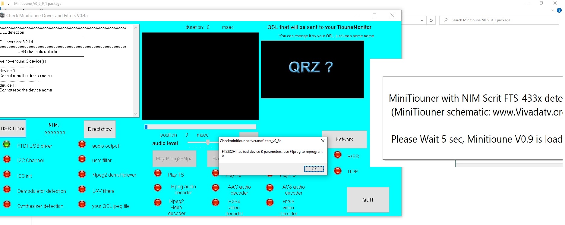

But, if I run the check WHILE MiniTioune is showing the white initialization screen, when I press the "USB Tuner" button the following error appears:
"FT2232H has bad device B parameters. use FTprog to reprogram it"
I attach a screenshot of the check response (The USB port must be busy).
If I kill the MiniTioune program with the Task Manager and I check Drivers and filters again, the check works as before, with no errors:

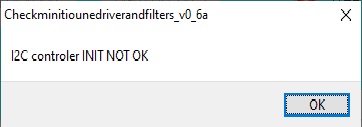

ONLY ONCE, after stopping MiniTioune with the Windows Task Manager, an I2C controller initialization appeared and the check gave:"
ERROR_MPSSE should be empty
Init MPSSE done!
But when i tried again with the MiniTioune stopped, the checks were OK again.
I attach screenshots.

This is what appears when I run CheckMiniTiouneDriverandFilters while MiniTioune is trying to start.

Messagede F6DZP » Dim 30 Aoû 2020 21:09
I don't understand and cannot answer.
One thing is sure : you cannot run 2 software that use the same MiniTiouner at same time.
so it is normal that if Minitioune is running, checkMibitioune driversAndfilters cannot access to the MiniTiouner.
If
1)TestMyMiniTiouner gives all result good
2)Check MinitiouneDriversandFilters shows all leds green
3) and Minitioune "does not go beyond the first -white- screen"
There is something wrong with your computer or Windows installation. or MiniTiouner or ????
About Minitioune and MiniTiouner, there is one thing I have not already put in my test: to be sure that you graphic card driver is not the windows generic basic graphic driver, but really the driver specific to your card. This is the only cause I can remember that could cause a new problem that I have not tested in the Check software "
so, if your new windows installation is well done = you have the good graphic driver (AMD or NVidia or ..) and have these trebbles, I cannot say why.
if you have not found the solution , to go further :
A) have you tested your MiniTiouner on another PC or a friend's PC that has alreday run Minitioune without problem using another MiniTiouner
B) have you tested another MiniTiouner (from a friend) that is known to be good?
