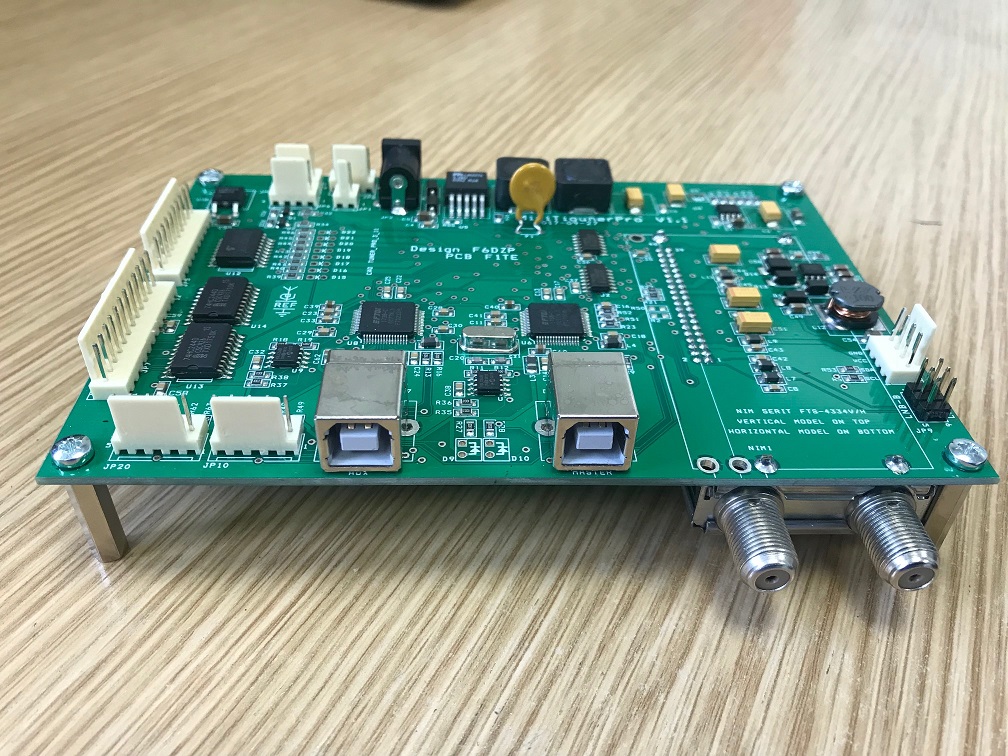

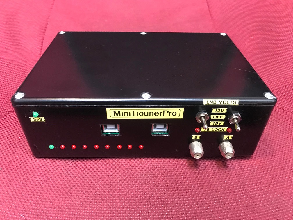

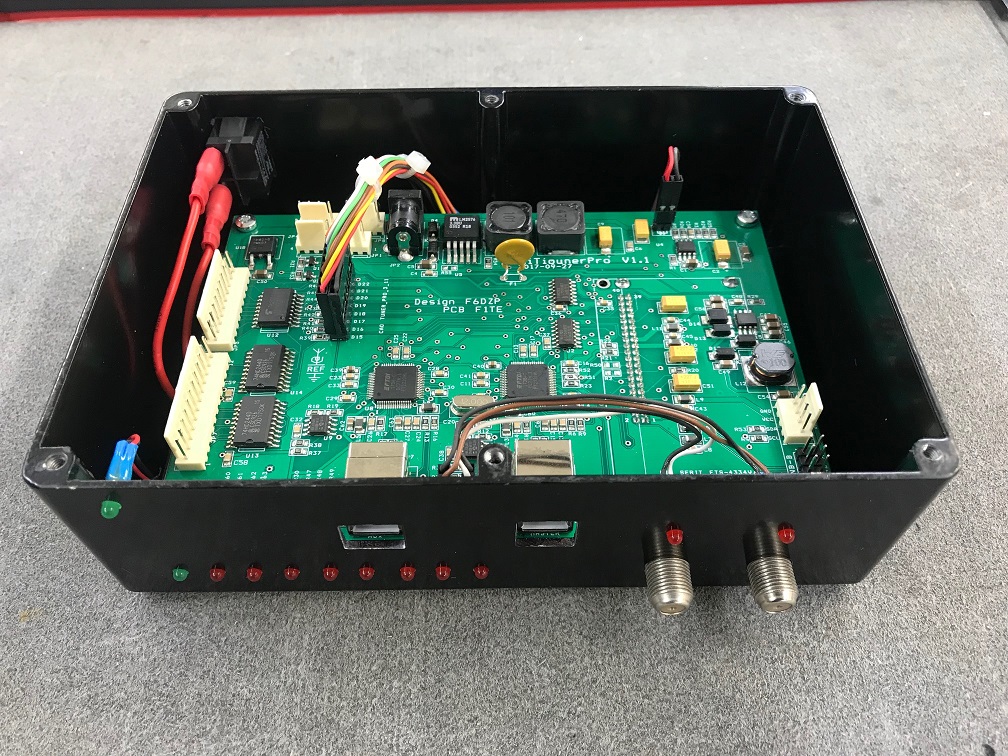

I have recieved a MiniTiouner Pro from REF.
But I have a problem the MiniTiouner software isn't detecting the "PRO" it shows only 1 reciever windows.
I have connected both USB cables, I also tested the board with the TestMyMiniTiouner_V2_0a software and al the test are running fine ( also the AUX Usb tests )
Do I need to config something in the software ?

hello,
When you start Minitioune, it says that it is a MiniTiouner Pro.
But Minitioune works only as a one frequency at a time receiver.
There is another software called Dualtioune that can work 2 frequencies at same time.
This software is actually beta tested and will be available next month.
