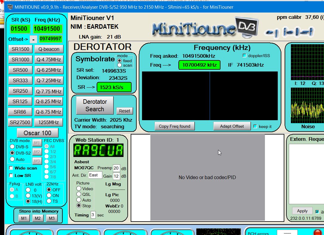

I built MiniTiouner hardware Version 2 according to the scheme from the site
https://wiki.batc.org.uk/MiniTiouner_hardware_Version_2

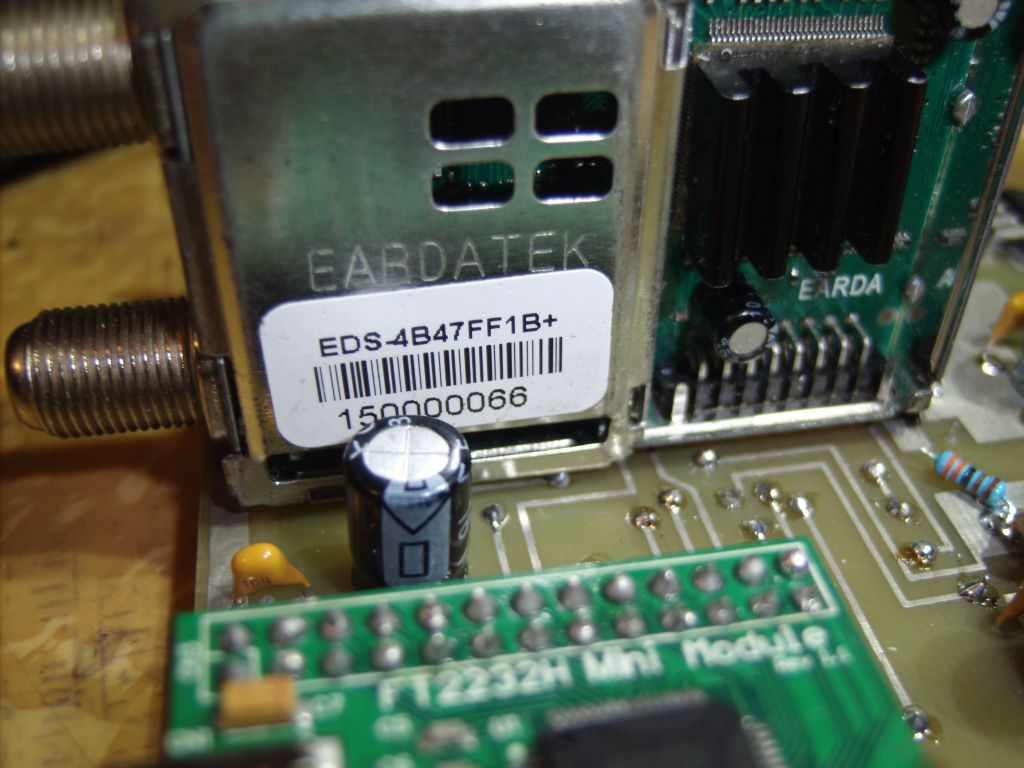

The Eardetek NIM tuner was used.
There are some problems.
The tuner is determined by the program, but the reception frequency is from 950-2150 Mhz.
How to change the reception frequency from 650MHz as the author writes on the site.
Help my.
RA9CUA Sergey
My MiniTiouner
Scan my screen

Messagede F6DZP » Mer 27 Jan 2021 20:14
You have built a MiniTiouner V1 that I have designed in 2015. (look at your photo, Minitioune says MiniTiouner V1)
look at the first post on this subject here:
http://www.vivadatv.org/viewtopic.php?f=80&t=366
The MiniTiouner V1 can use a Sharp, Samsung or Eardatek NIM tuner.
A Sharp or Samsung NiM we have used at this period can be set from 650MHz to 2450 MHz(tuner chip: STV6110)
The Eardatek NIM model we have used can be set only from 950 MHz to 2150 MHz due to the Hardware (tuner chip is a STB6100). It is written just after the title on the MiniTioune photo you give.

hope that the answer to my question will serve as information for those who will have an attempt to make a tuner on Eardatek EDS-4B47FF2B +.
Thank you so much for answering my question,I will now use this device with a frequency converter.
