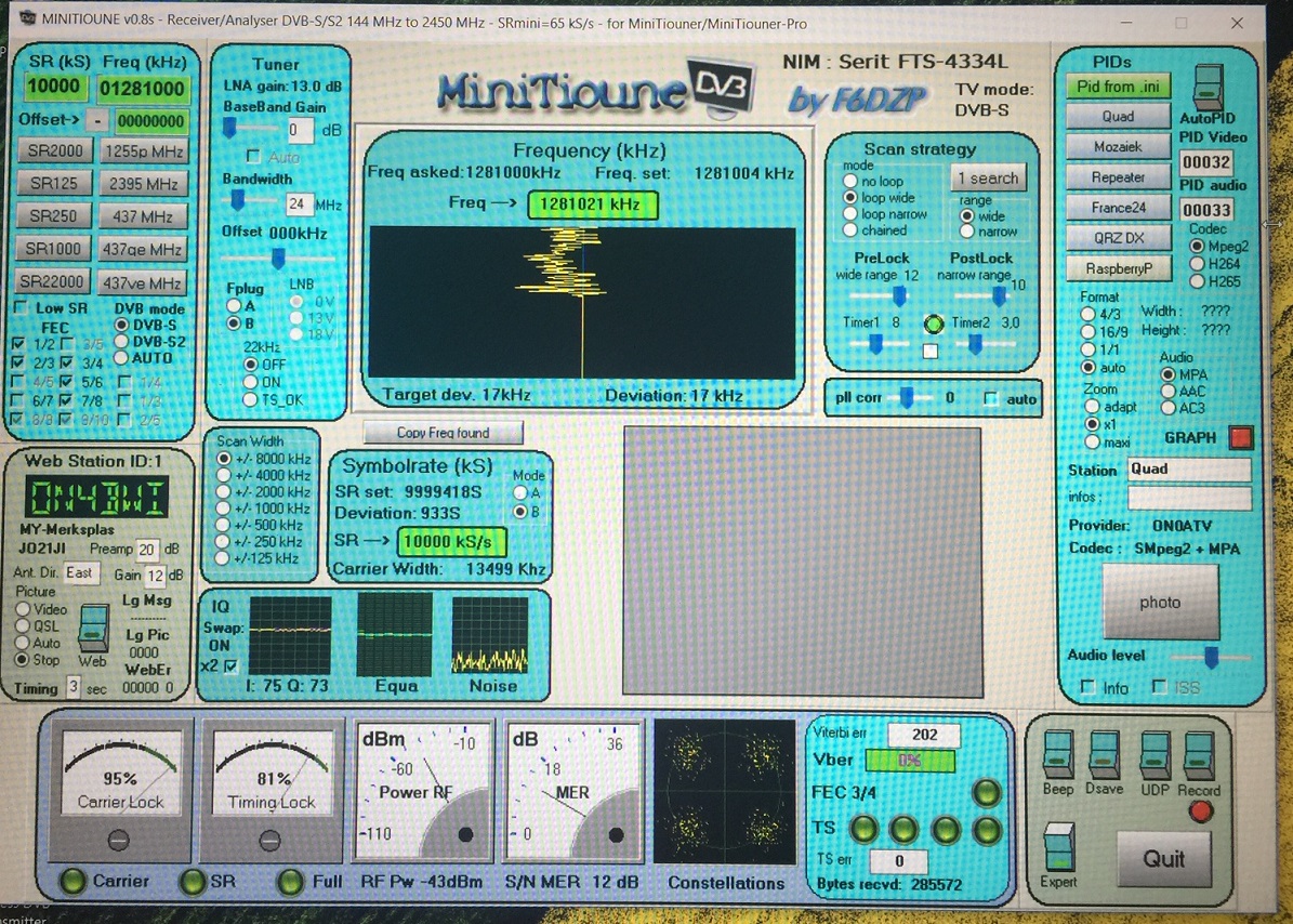

Hi All
i just install the software and the drivers and like to receive a local atv station but i receive good signals like you see on the photos but I don't see any video streaming?
I try also with vlc player but still noting?
Can anyone suggest what I can do for other things ?
best Regards Willy ON4BWI

Messagede F6DZP » Jeu 3 Jan 2019 08:50
First problem : The led graph is red.
Before you use Minitioune, first test your installation using "CheckMiniTiouneDriverAndFilters_V0_5a".
You will see that you have not installed some tools or codec.
Only when you will get all led green, you can come back to Minitioune.
You have a second problem if VLC cannot show the video, but perhaps it is because you have set/use the good UDP address?
or because the PID used don't correspond to a free channel?
Your are receiving a stream, because we can see 'Bytes received : 285572
