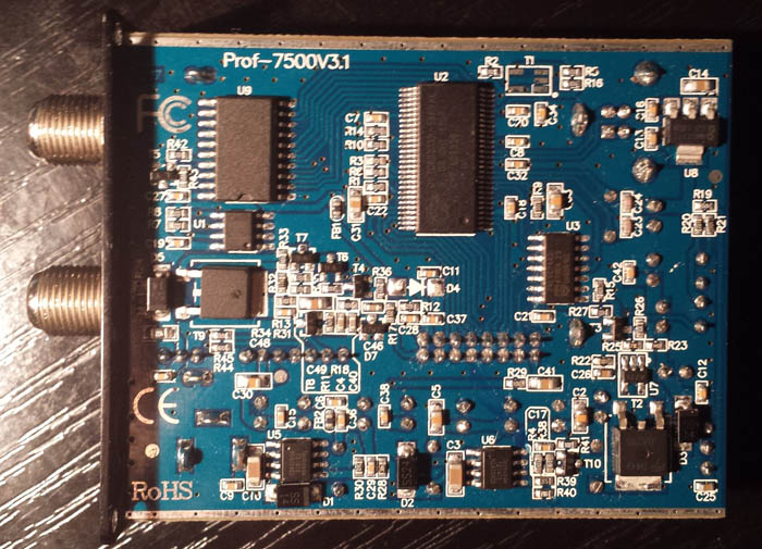

The USB chips used with almost USB tuner of the market is the CY7C86013A.
(Prof7500 = NIM EARDATEK + CY7C86013A, STB5980 = NIM EARD + CY7C86013A ......)

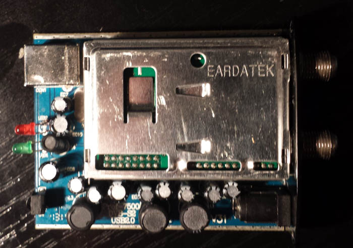

on this side there is only the Nim Tuner EARDATEK and capacitors
We can see on this side, that there are only component for power supplying the Nim tuner + power supply for LNB and CYC786013A for usb interface.
I have began 2 months ago to study this chip, but it is a very powerful chip that takes time to develop for the first time with it and my chineese sample was not sure to work well.

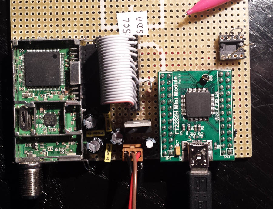

So I have chosen to test also a second solution less powerful but less "eating time" : use the FT2232H I already used with my Digilite modulator.

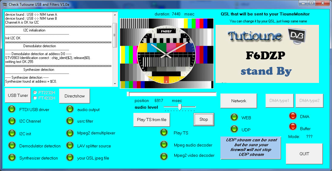

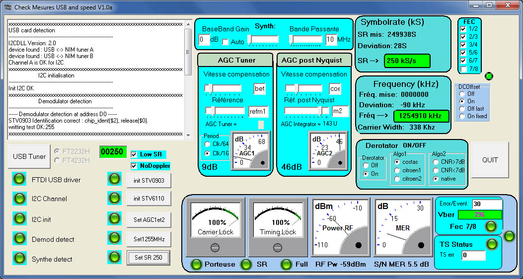

My first step was to test the I2C dialog between FT2232H minimodule and the Samsung NIM
And now develop Check software for this first build
Check USB tuner.jpg (195.74 Kio) Vu 120253 fois
As now I have made good test for this first step, I go to the second step : program the chip inside the NIM to check if I can lock on a DVB-S signal and specialy a very low SR signal (SR250)
Well! I am in the good way

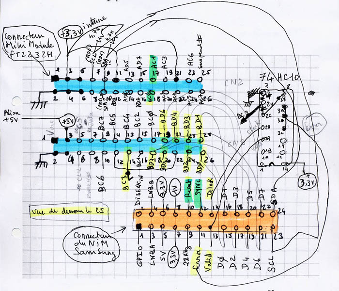

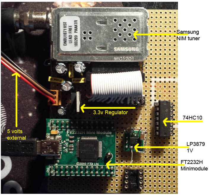

Last step:
I chose to use 5V external power supply, so I have to give on this board the 3.3V and 1V need by the demodulator
I want also now get the TS data coming from the NIM tuner when it is locked, so I add a 3 NAnd gates 74HC10 and wire bus between the NIM and the Minimodule
montage avec NIM samsung_txt.jpg (139.91 Kio) Vu 120253 fois
That's all!!

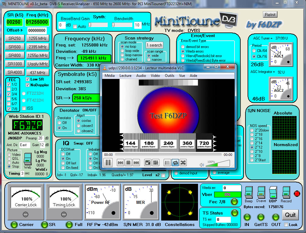

If we don't need anything else ( 13v or 18V for LNB and 22kHz) the schemtic is complete. Nothing to add! and it works very well at very low SR ( down to SR125 kS/sec)
vLC receiving TS from Minitioune1.jpg (328.87 Kio) Vu 120253 fois
As you can see there is a new software that can be used with this MiniTiouner : Minitioune.

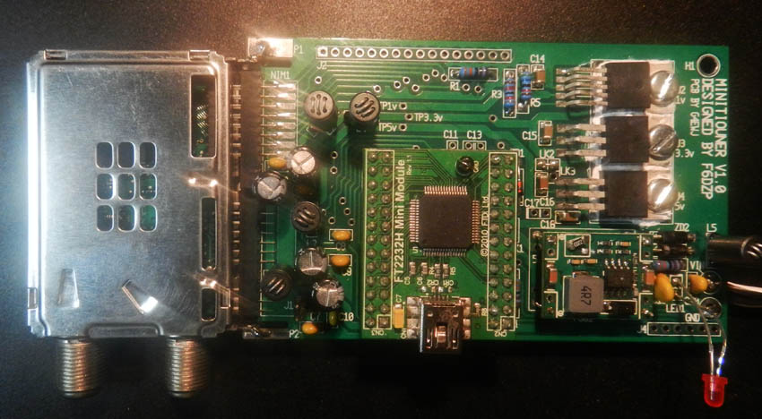

Messagede F6DZP » Lun 6 Fév 2017 05:54
In UK, the BATC has made a pcb and a kit.
BATCkit _Sharp_.jpg (102.64 Kio) Vu 118301 fois
More information here:
http://www.batc.org.uk/forum/viewtopic.php?f=15&t=4225
pcb, NIM, Minimodule are available at the BATC shop.

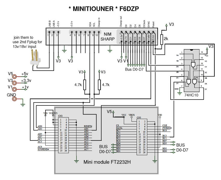

Schematic
My first prototype using a NIM Samsung DNBU10711IST
schéma crayon Minitiouner sans alim.jpg (140.75 Kio) Vu 110697 fois
montage avec NIM samsung_txt.jpg (139.91 Kio) Vu 110694 fois

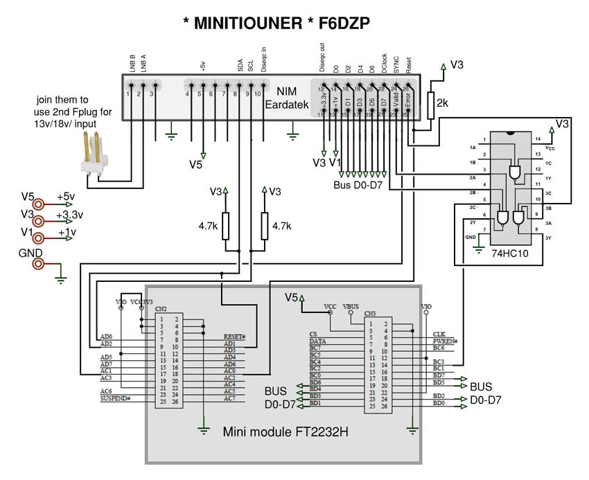

Using the NIM Eardatek EDS-4B47FF1B+
Schema Minitiouner_Earda_.jpg (104.66 Kio) Vu 110697 fois
Using the NIM Sharp BS2F7HZ1069
Schema Minitiouner Sharp_.jpg (106.15 Kio) Vu 110697 fois

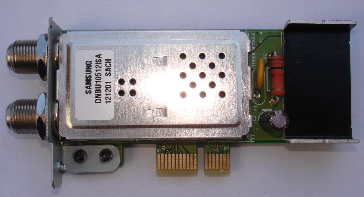

Messagede DB1AFN » Mer 30 Mar 2022 19:47
Just as an additional information...
On this site
https://forum.batc.org.uk/viewtopic.php?t=4102&start=20
the DNBU10512ISA is listed as a potentially suitable NIM, but with a question mark.

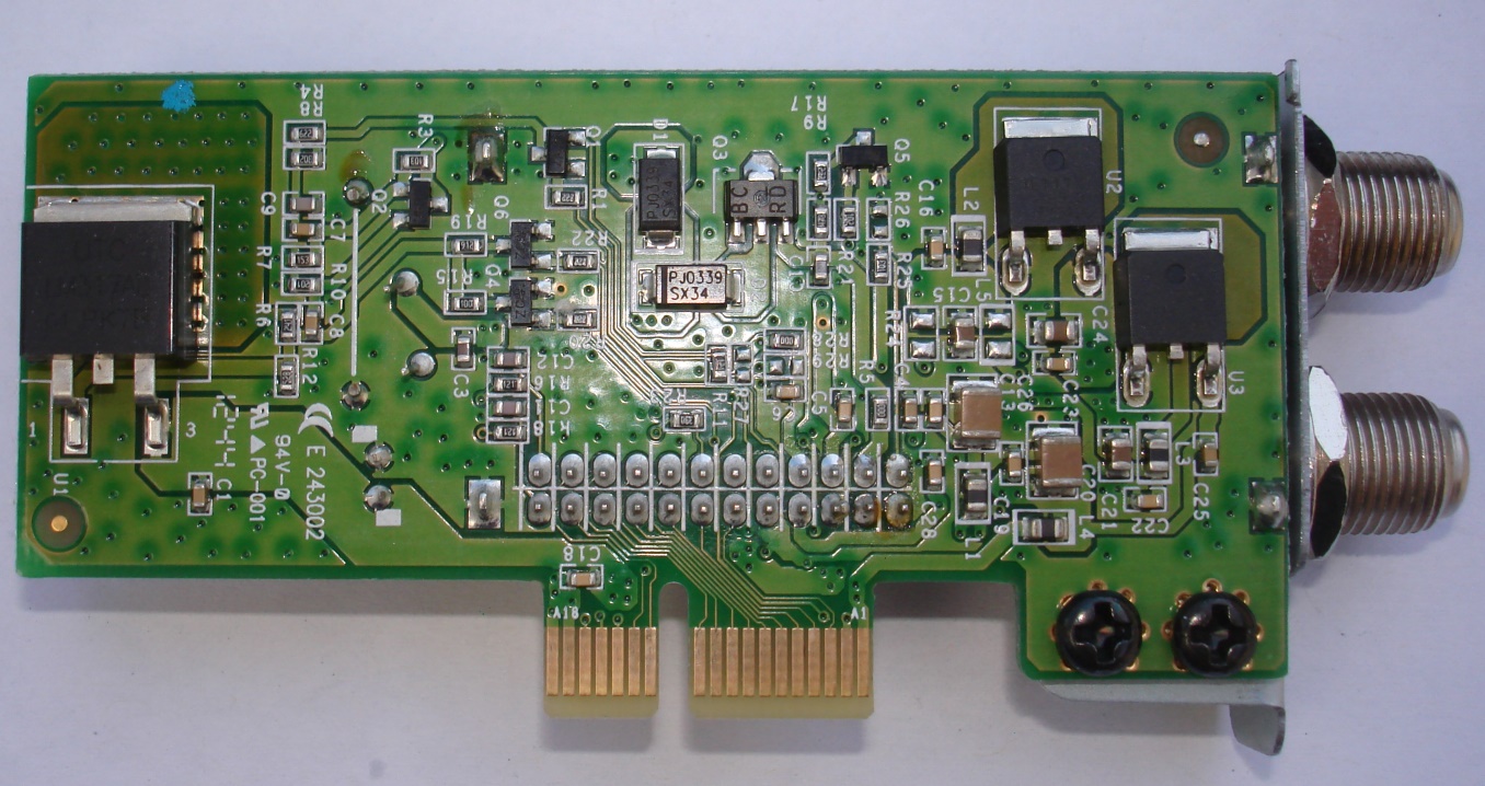

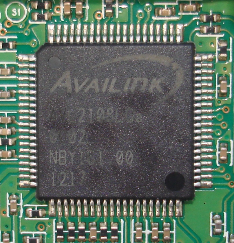

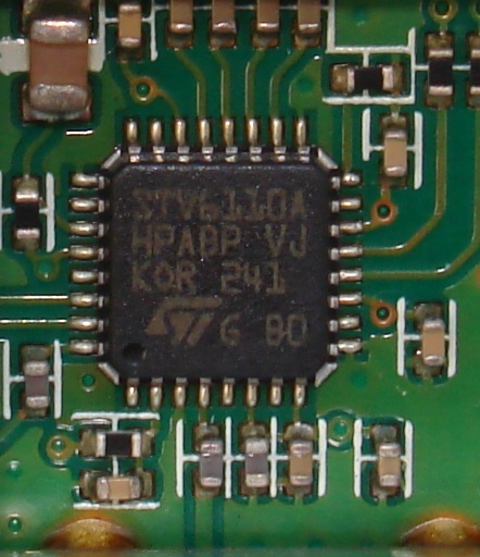

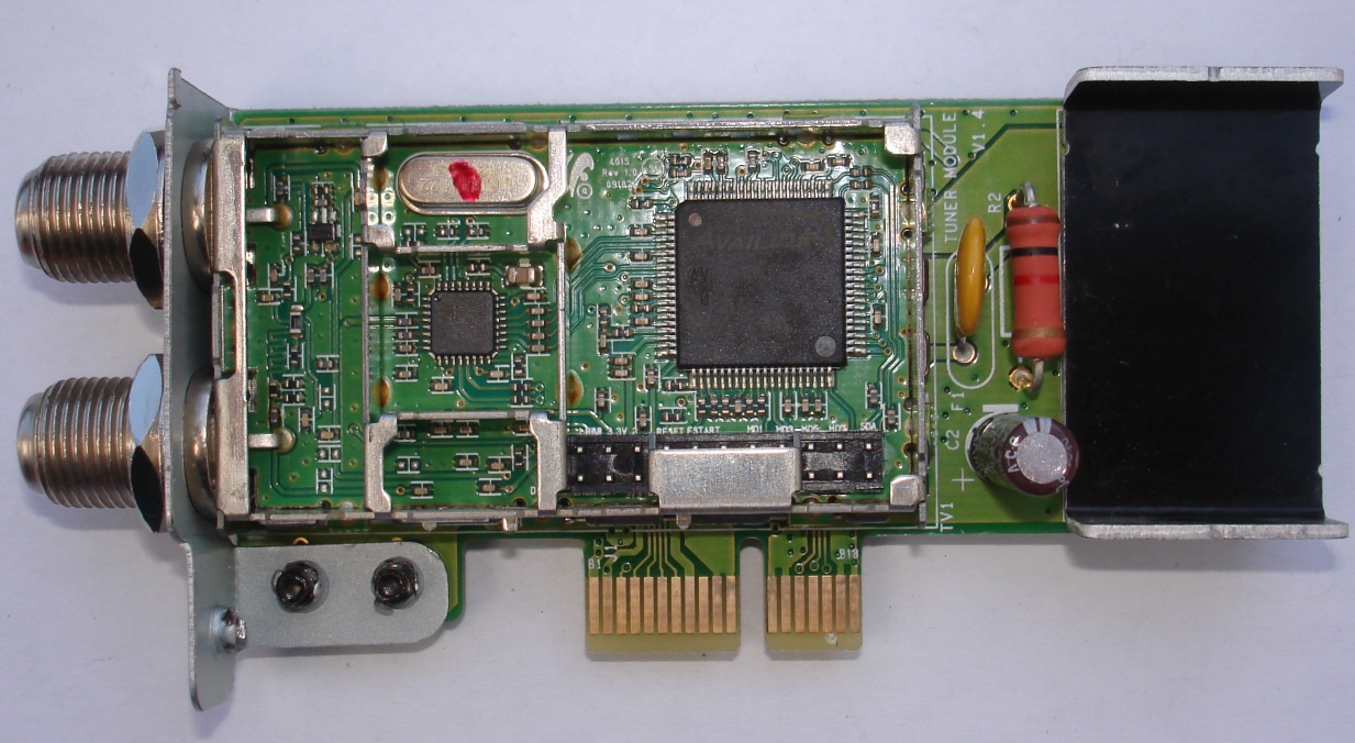

Here is what is inside of this NIM:
DNBU10512ISA with cover.jpg (289.87 Kio) Vu 83573 fois
DNBU10512ISA without cover.jpg (367.46 Kio) Vu 83573 fois
DNBU10512ISA STV6110A.jpg (103.7 Kio) Vu 83573 fois
DNBU10512ISA AV2108.jpg (361.7 Kio) Vu 83573 fois
DNBU10512ISA PCB.jpg (362.53 Kio) Vu 83573 fois
The tuner is an STV6110A and the demodulator is an Availink AVL2108LGa.
So it probably won't work with MiniTioune.
