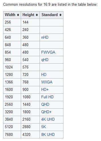

Re: FreeSteamCoder V2.50 for DVB-S DVB-S2 DVB-T
Postby createmedia » Mon 20 Sep 2021 00:27
Hello
I am using streamer 2.5 with DATV Express and VMix 24.0.0.66.
Very good to have the User Interface.
Virtual Audio Cable as an audio source would be nice please
333k/s source VMix 1280 by 720.
Sound is intermittent. Reduce resolution to 864x486 in VMix sound OK but no 864x486 resolution setting in streamer says 1280 by 720 but crashes Minitioune after about 5 minutes of transmit. Minitioune happy with 8PSK and 16 or32 APSK with all other settings the same.
There is a poor match between the allowed frame sizes in VMix to The frame sizes available in the streamer.
Mike G8LES
createmedia
Posts: 6
Joined: 07 Mar 2019
Postby F1EJP » Mon 20 Sep 2021 19:57
Bonjour Mike
La résolution de sortie n'a pas besoin d'être identique à celle de l'entrée.
La résolution proposé est par défaut mais vous pouvez en choisir une autre.
Si ffmpeg utilisé par le logiciel plante vous devez choisir la résolution inférieure 960x540
Dans une prochaine version je proposerais plus de choix de résolution mais en restant dans les standards uniquement en video 16/9
Hello Mike
The output resolution does not need to be the same as that of the input.
The proposed resolution is by default but you can choose another one.
If If ffmpeg used by the software crashes you must choose the lower resolution 960x540
In a future version I would offer more choice of resolution but remaining within the standards only in 16/9 video
source Wikipedia:
