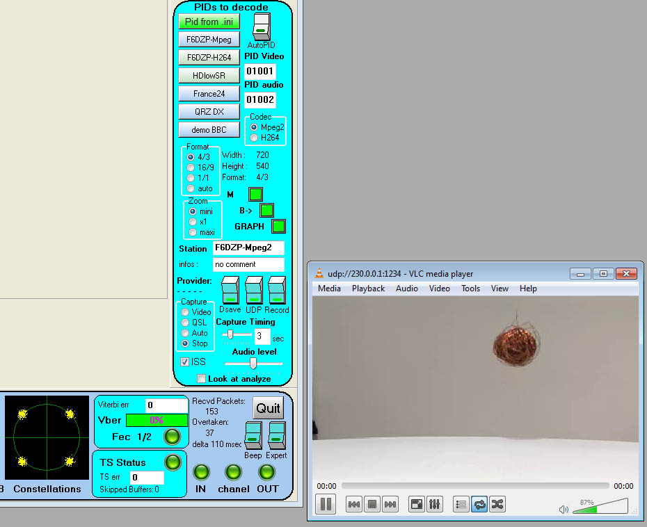

You can enter in a new world using UDP.

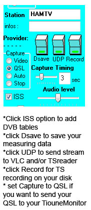

You just need to have a local network active on your PC and press the UDP button in Tutioune.
Tutioune1600 setup 3 buttons ON.jpg (58.78 Kio) Vu 19568 fois
Now if some TS packets are received they are automatically sent to your local network. So you can open several software to decode the stream (VLC), to analyse the stream ( TSreaderlite...), to send in real time what your are receiving to your DVB modulator ( Digilite set in UDP mode, ...) so with this method when Tutioune receive a DATV station on 437 MHz, I can in real time send back this DATV stream on 1255MHz. So you have a repeater or transponder for free!
So I suppose Tutioune has its UDP button ON (I put it ON before I receive HamTV, but you can do when you want and stop it when you want)

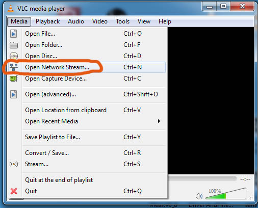

- first tell VLC to open a network stream :

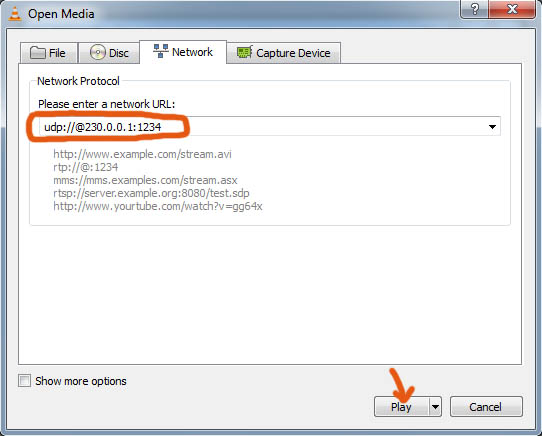

Now give to VLC the URL used by Tutiune to broadcast TS on UDP :
VLC giving UDP URL.jpg (54.95 Kio) Vu 19568 fois

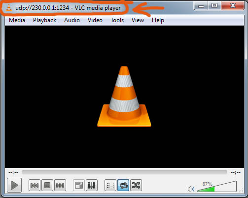

Now VLC is waiting for a UDP stream, we can see that on the top:
VLC waiting UDP stream from Tutioune.jpg (47.92 Kio) Vu 19568 fois
and VLC will show the video when it will receive the TS via UDP :
VLC receiving UDP stream from Tutioune.jpg (152.31 Kio) Vu 19568 fois

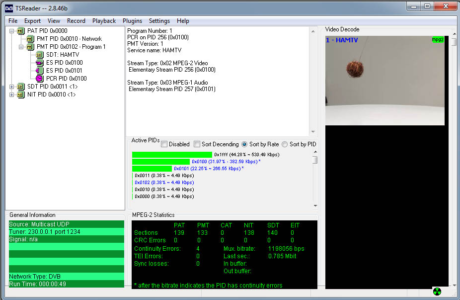

At SAME TIME you can also start TS reader in UDP mode to analyse the stream :
you will see that :
TSreader receiving UDP stream from Tutioune.jpg (137.7 Kio) Vu 19568 fois
