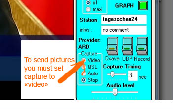

Postby F6DZP » Thu 6 Mar 2014 08:22
If you want to send pictures to your TiouneMonitor, you need to set the capture button to "Video"
If you set it to "QSL" you send your QSL
if you set it to "auto" you will send your QSL when receiving nothing and pictures captured from video when you will be decoding.
tutioune set capture.jpg (46.71 KiB) Viewed 71505 times
Size of pictures in TiouneMonitor cannot be changed.
You can change zoom of Map using your mouse wheel.
