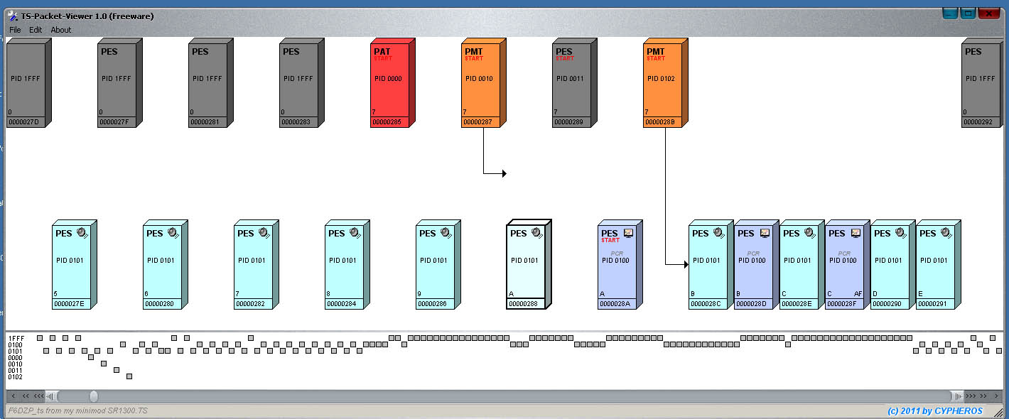

we can see different packets: Grey packets are "Null packets", they content nothing usable, white packets PID $101=257 are Audio packets, blue packets PID $100=256 are video packets and other colors show PAT, PMT... packets
TS from my minimod SR1300_packet viewer.jpg (140.16 Kio) Vu 133104 fois
To be able to reorganize data to put video data together, audio data together and decode them, we must know where they are (their PID) and at which channel they belong.

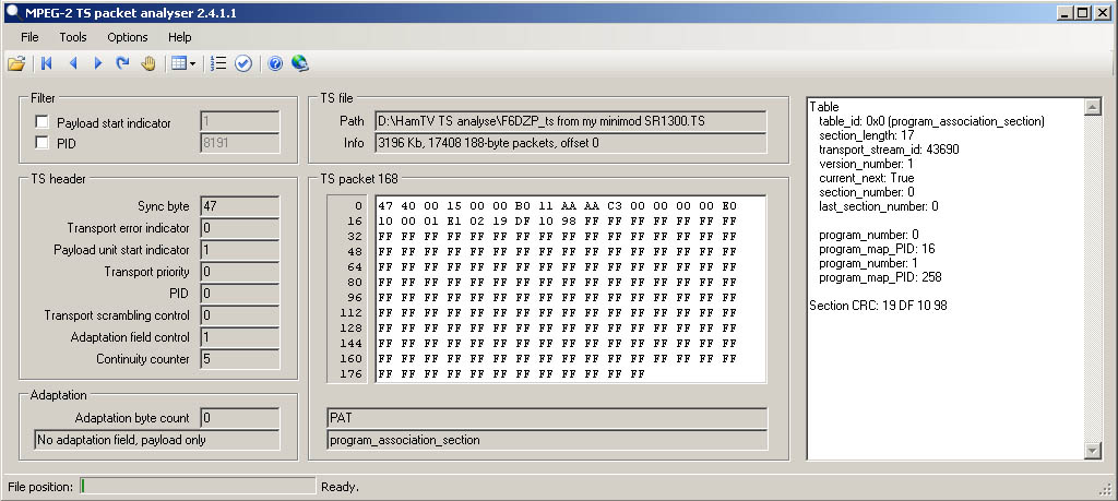

We can see that this PAT tell us that there are 2 PMT, Program_number 0 with PID16 and Program_number 1 with PID 258
PAT from my minimod SR1300_packet analizer.jpg (142.32 Kio) Vu 133104 fois

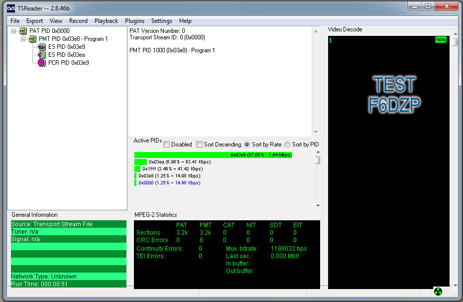

This TS show a PAT that content only one PMT that describe 2 ES ( elementary streams) video PID $3e9=1000 and audio PID $3ea=1001. For this Transport stream coming from a SR1300 kS/s fec 1/2 we have a total of 1 198 kbps, 1 040 kbps is used for video, 84 kbps is used for audio, 41 kbps for Null Packets, and 15 kbps for PAT and PMT
TS reader normal SR1300.jpg (119.77 Kio) Vu 133104 fois

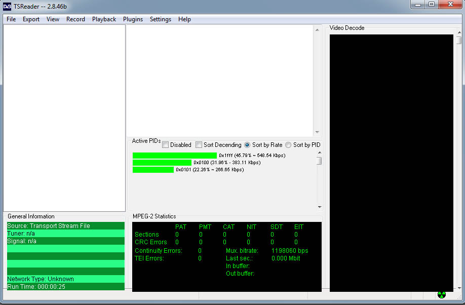

In HAMTV DVB multiplexer, there is a bug in the firmware, so there are absolutely no packets describing tables: no PAT, no PMT, no NIT, no SDT..
So any professional DVB decoder or any receiver that want to observe strict DVB standard will not accept this transport stream that is not DVB compliant. Nothing to see, nothing to hear..
HAMTV transport stream for SR1300, fec 1/2 => total data rate 1 198 kbps Too much data rate for Null packets! and also too much data rate for audio! so video data rate is only about 350 kbps
No PAT, No PMT. so we just see data at PID 256 and 257 but don't know what it is

Using a computer and a software like Tutioune will allow us to receive the BAD transport stream coming from HAMTV and to add in real time the tables that are not present.
So the Transport Stream recorded or sent via UDP to VLC, TSreader will have all tables.

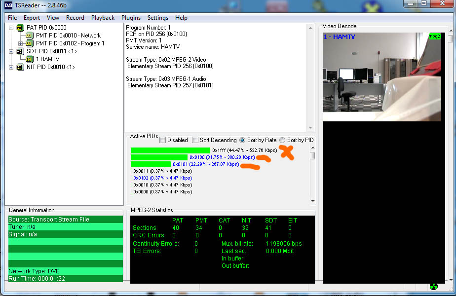

HAMTV transport stream has bee corrected in real time by Tutioune : we can find all tables. But we cannot change poor data rate given to video!
HamTV TS corrected using TSreader.jpg (136.34 Kio) Vu 133104 fois

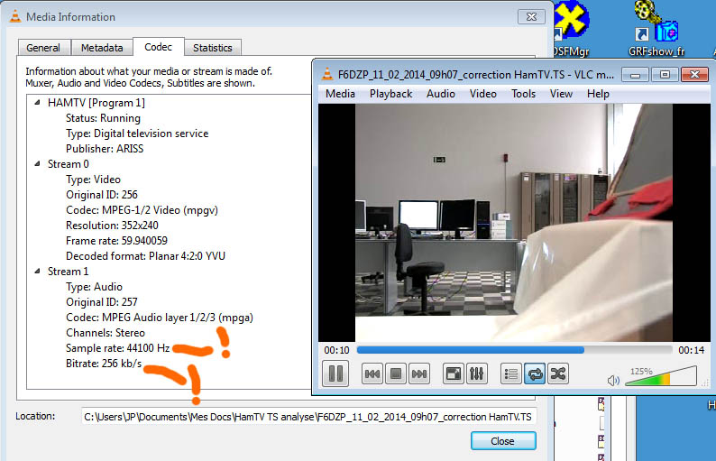

VLC gives some info about the stream :
audio bitrate is too much :256 kbps! we don't need that for just a voice in a microphone, 32 kbps or 64 kbps is enough. and 44100 Hz is a sample rate that is never used in DVB broadcasting, we must always use 48 kHz!
HamTV TS corrected using VLC.jpg (121.05 Kio) Vu 133102 fois

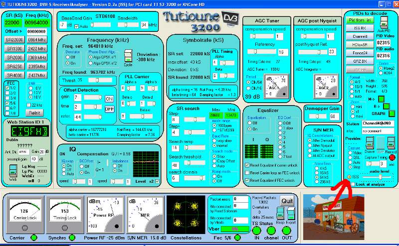

Here you can download specific beta version of Tutioune that has a button "ISS" that you must check when you receive HAMTV. This will add DVB tables that are not present in the transport stream.
( Tutioune does not decode for the moment with this beta version , but can record the corrected TS to Hard disk, or send it to VLC or TSreader using UDP).

Messagede zg3409 » Mer 5 Mar 2014 18:23
ISS Button
Above is the extra ISS button. Thanks to F6DZP for this.

Messagede F6DZP » Jeu 6 Mar 2014 15:07
Ok, sorry for that. I have made the modification.
These 2 new versions allow to receive HamTv with Tutioune, decoding video and audio if you want.
but as HamTV audio is not set as it would do ( 44100 kHz is not used in DVB format, the Microsoft Audio decoder can do some click)
If you send via UDP to VLC and not use Tutioune for decoding ( just by NOT giving it the video and audio PIDS), VLC will decode audio with its own decoder and audio is better.
